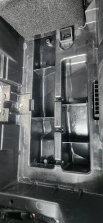

Another forum member found bolts at the bottom of his battery tray in a factory fresh RHO. He also found liquid, so the bolts likely punctured the battery case. No wonder it died.
Has anyone else who has experienced a dead battery pulled the battery & found bolts in the tray? I wonder if the dealer techs would report it to an owner? Maybe…maybe not.
That was me, bottom of the battery was fine, there's big gaps/valleys in the tray
