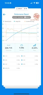

Mine saying 400hp as well, only was able to pull a 5.4 0-60 as well
Could be weight full tank maybe a passenger mixed with hot temps and bad road conditions. Could be a ton of reasons. Only way you'd know if power is missing was toss her on a dyno.
What were you able to get for a 0-60 prior to the flash?
Whats your elevation and ambient temp?
Trying to assess if this is a change for you or this is your normal.

Best was 4.7. I'm still getting max boost, and the truck feels the same... but is it!?!?

Your graph Y axis differs from mine.
