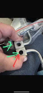

Just have to say i had order the Kit. Got it yesterday attempted to Install it today they looked nice in the box u take them out couple lil spot had ships of missing paint for one. Box was pretty well packaged. Prepared both calipers with pads. And lines etc. thank God i never disconnected my caliper or line or Cut ( even u really dont need to cut like they say cause it doesnt touch at all. But when pre filling calipers with brake fluid one caliper was. Leaking from banjo bolt. Before i torque anything i chat with them and call them and they gave me tq specs. Guess what. The caliper at least the one i got one out of two leaked and banjo threaded area on caliper with the torque they said. Went bye bye. And stripped. I cant tell the caliper material is not of high quality material if it stripped with the lil torque. And the braided line where the washer sits u can tell no quality inspection cause it was done incorrectly cause it to leak so i ended up sending them back today and wait for my refund. If no quality inspection then what tells me seals and other things will not last or crack or leak and paint it self was chipping easily
Im happy for the ones that got it installed and no issues. But not my case
my 2014 vehicle with 6 piston front Brembos and 4 piston rear. Has NO Paint chip and no issues at all
Did you join the forum just for this it seems? Curious is all. Did you purchase through us or RC directly? I don't see any tickets in our system or emails from anyone having this issue, but if you purchased through us & need support please reach out immediately!
I ordered straight to RC. And then searched online this forum came up and just posted my issue I didnt have good luck with them. The price is awesome. But no quality inspection Etc wish they did worked out on the first time but now is kind hard to believe in trying to buy another set i might buy a different brand but in the mean time see if other people have success with them and paint not chipping easily etc
