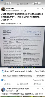

so there is a bulletin out now on the speed as an update? anyone else seen this?
What’s the bulletin? Are you referring to the old recall that was to change the top speed to 98 for export trucks? Or something new?
That might be it..

Somewhere on here is the SW part # that was put on the 98mph club RHO's. They should be able to check software level to confirm rather than driving.
Is this what your are referring to?
Basically this is the software that has the issue compared to others workout it?

Yes, the dealer can check SW Version... and I'm pretty sure there is a bulletin for the EU trucks that this was supposed to go on ONLY. If the dealer is not logical enough to figure that out by putting two and two together I'd find a new dealer.
