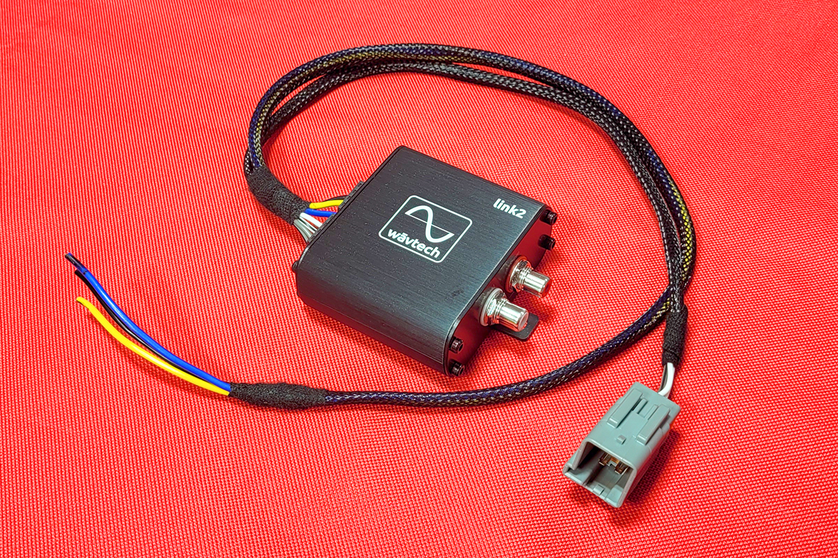

Also, netaudio has a plug and play converter and anc bypass available.

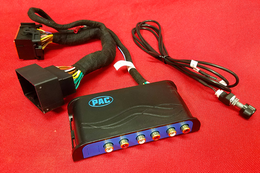

When you guys talk about a PAC harness I could be wrong but I believe that’s added in line with the factory amp, so you’re working off a boosted signal from a low quality amp that’s not clean with a high noise floor. I tried a PAC harness on the Limited and the SQ was terrible. The DSP helped, but it was still terrible.
So is this PAC harness you guys are expecting likely to also be an inline device or is PAC now producing harnesses that completely bypass the factory amp?

The PAC AmpPro is what we are specifically talking about. Last I checked they still haven’t cracked the new electrical architecture so SOL on full aftermarket systems without a ton of work. It undoes all the shitty EQ from the factory amp and provides a clean flat signal to send to your dsp/amp. You have to keep the factory amp or you will lose all the other controls that are handled through that amp (turn signal sounds, parking sensors, etc). And in order to keep the factory amp you have to use the AmpPro to trick the amp into thinking that it still has all its speakers in place (resistance on factory channels) or your system will basically stop working or go crazy.

Would ANC be lost by just adding subs? I’m debating adding two 10’s in a stealth box but the shop I talked to never mentioned how we’re handling the ANC and if it can be maintained.
Yes you will need to get the anc bypass harness or you will get noise when putting subs in. You will need a subwoofer converter like the wavtech one net audio sells and then the like $10 or $15 anc bypass harness.
*Edit* The converter that net audio sells comes with the bypass harness. Also I remember speaking with them on this, since this doesn’t bypass the amplifiers crossover tune, I believe you are stuck with the frequency range that the factory system has in place. 30-80 hz. Only way to get your own frequencies is when pac figures it out and releases a new AmpPro. This is a temp fix to get subs in there imo.

I just spoke to Net Audio and they said this device below will allow you to add a sub to the RHO. They said they haven’t given up on a larger solution that would allow you to change the speakers out and add amps and a DSP for them but they said the factory speakers are pretty good, it’s primarily bass that’s lacking. This will be my first project when I take delivery of the new RHO.
